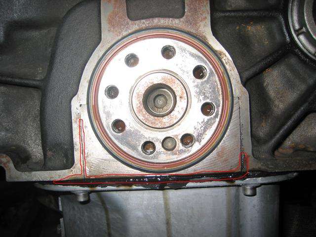

Some news about my oil leak which makes me mad
After changing the gasket of the crankshaft, it still leaks.
And it's not easy to find where it comes from with the flywheel
And then I thought about this oil screw
So dismantling again ...
And it still leaks
So I putted down the gearbox and turned on the engine without the gearbox.
I guess it leaks from the bearing of the crankshaft or from the sump gasket.
The picture is the engine which turned on 5 min
The picture is the engine which turned 10 min
The sump gasket was changed after the 2nd gasket of crankshaft

Did you use enough sealing compound on the last bearing cap? It even looks like you don't use any if thats the case it will always leak there.
+1.000
Frank at this point it's necesary to use sealing compound.
