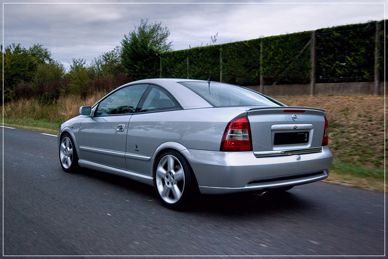

Let me introduce you a quick small turbo project from France .
A 2001 Astra coupe turbo that went thru some modds since i got it two years ago .
Here it is in "stock mode "
Side 2 Side with my Ex 1.8L Z18XE ( my Wife's but sold for a BMW E90)
