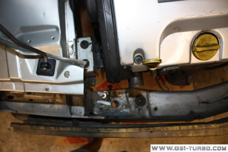

This gray Corsa for parts and testing the installation of V6 engine.
Franck
Franck
20.09.2001
238
Paris
Engine X30XE
Intake C25XE
Ecu and electric beam C25XE
GearBox F18 ( Vectra A 1.7 TD )

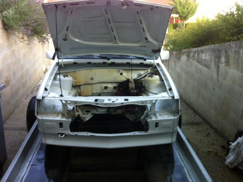

Welds reinforcement kit.
New paint in the engine compartment.
